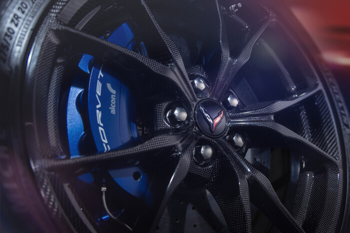

The ZR1X balances impressive power with robust brakes specifically developed with this car in mind. The J59 braking package, standard on ZR1X and an option on ZR1, is a clean-sheet design intended for superior heat resistance and ultra-responsive braking.
Alcon 10-piston front and 6-piston rear calipers are mated to 16.5-inch front and rear rotors — the largest diameter rotors ever offered on Corvette. The rotors are carbon ceramic, constructed with continuously woven carbon fiber threads.
This is the most resilient production car braking system we’ve tested within GM. And during testing, we saw J59-equipped Corvettes achieve 1.9G of deceleration from 180 to 120 mph.
