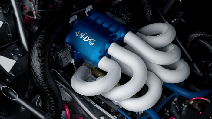

The arrival of this engine is the real heart of this rolling laboratory. It has, therefore, been installed in a case that leaves it visible. It is protected by glass tinted with a touch of blue, while the engine bay has been carefully designed down to the smallest detail. The iconic shape of the rear window, reminiscent of the A110, incorporates two transparent NACA air intakes that feed two ducts leading to the gearbox oil cooler, contributing to the impression of lightness. The plenum (air intake manifold) stamped with a Hy6 logo recalls the treatment of the cylinder head covers on old racing cars. New air intakes have been incorporated to ensure the cooling of this larger engine, with a series of 3 louvres (x3) to ensure ventilation and contribute to the safety of the hydrogen engine’s environment.

The new Alpine Hy6 V6: a unique engine entirely powered by hydrogen
The Alpine Alpenglow Hy6 hydrogen-powered rolling prototype is designed as a genuine race car based on an LMP3 carbon chassis. From the outset, the chassis has been designed to match the performance offered by the all-new Hy6 V6 engine, which more than doubles the power output compared with the 4-cylinder engine used in the first demo lab. Conceived from a blank sheet of paper, the Hy6 V6 is an unprecedented engine purposely developed by the Alpine teams at Viry-Châtillon for use with hydrogen. Two years of work went into its development. It was a considerable engineering challenge regarding the specific features of hydrogen combustion, which gave rise to an exceptional increase in expertise. Oreca is the technical partner that has made it possible to implement this savoir-faire in the engine’s design.
The engine is a 3.5-litre V6 open at 100°, supercharged by two turbochargers. It consists of a solid aluminium engine block with a dry sump. A crankshaft with crankpins offset by 20° ensures smooth ignition. The cylinder heads are made from cast aluminium with an optimised cooling circuit. At the same time, valve timing is ensured by 4 chain-driven overhead camshafts and 4 valves per cylinder controlled by finger cogs. It is a ‘super-square’ engine with a 95 mm bore and 82.3 mm stroke, a highly advantageous format at high revs. The sound emanating from the Inconel exhausts system has been specially tuned to sing all the way up to maximum revs of 9,000 rpm. The engine’s maximum power output is 740 bhp at 7,600 rpm, corresponding to an impressive specific power of 211 bhp/l for a top speed of over 330 km/h. A centrifugal clutch and an Xtrac sequential gearbox assist this Hy6 engine. Its development philosophy initially favours a version designed for racing but could be transposed to series production.
Formula 1 engine development methodologies have been used to define and fine-tune the elements at the heart of this engine’s performance. The combustion chamber is designed to use hydrogen (more precisely, dihydrogen H2), favouring turbulent movements to ensure that the mixture is homogeneous before the spark. It is a crucial point as hydrogen ignites over a wide range of richness, which makes it prone to generating abnormal combustions: pre-ignition (spontaneous auto-ignition before the spark plug sparks, producing extreme pressure levels), or knocking, which generates auto-ignition and shock waves. Particular care must be taken in preparing and injecting the mixture, supplemented by indirect water injection, which reduces Nox emissions while preventing these phenomena.
The three Alpenglow Hy6 tanks store hydrogen in gaseous form (2.1 kg each) under high pressure: 700 bars. They are located in the sidepods and aft of the cockpit, in ventilated compartments and sealed off from the passenger compartment. A pressure regulator reduces the pressure from 700 to 200 bars before dropping to the pressure required for direct injection into the combustion chamber.
Numerous measures have been taken to ensure absolute safety. The 700-bar composite cylinders are Regulation 134 certified*, valves have been incorporated for rapid fuel evacuation in the event of fire, hydrogen presence sensors are constantly on the lookout, a rigorous start-up procedure has been adopted with numerous checks, and, finally, a colour-coded system alerts the driver and emergency services according to the degree of severity of each type of incident.
