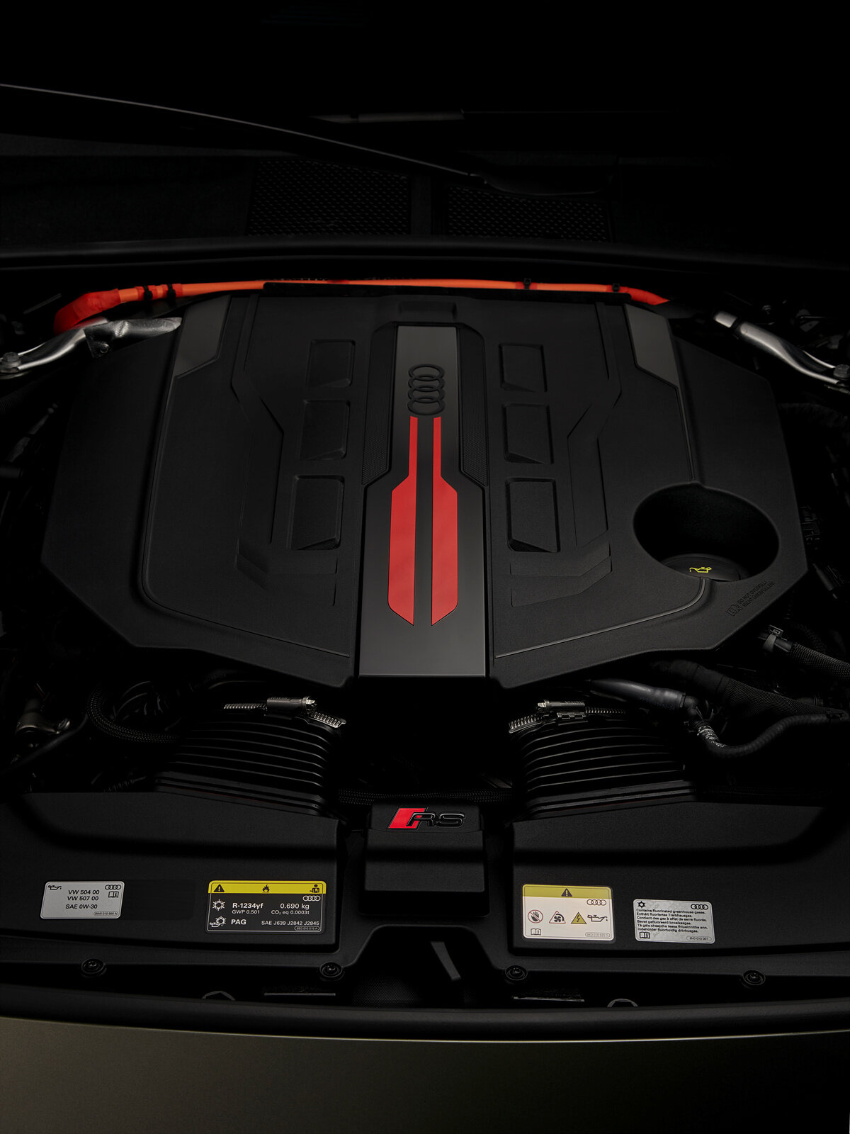

2.9-liter V6 TFSI engine: 375 kW (510 PS) of power
Putting out 375 kW (510 PS), the improved 2.9-liter V6 TFSI engine in the RS 5 (Fuel consumption (weighted, combined): 4.5-3.8 l/100 km (52.3-61.9 US mpg) (preliminary values); power consumption (weighted, combined): 18.7-17.7 kWh/100 km (preliminary values); CO2 emissions (weighted, combined): 102-86 g/km (164.2-138.4 g/mi) (preliminary values); CO2 class (weighted, combined): C-B (preliminary values); Fuel consumption on discharged battery (combined): 10.2-9.5 l/100 km (23.1-24.8 US mpg) (preliminary values); CO2 class on discharged battery: G (preliminary values) contributes noticeably more power than the previous generation. The increase of 44 kW is due to continuous performance-oriented development by Audi Sport. The RS 5* uses a modified Miller cycle that offers significant advantages under partial load. In the Miller cycle, the intake valves close earlier, increasing the engine’s efficiency.
Two variable-geometry turbochargers provide boost; the piping is optimized for high pressures and minimal losses. This means the engine responds much more eagerly to throttle inputs. The increase in power and torque meshes perfectly with the 130-kW electric motor. Additionally, Audi has upgraded fuel delivery through higher injection pressure, increasing efficiency and providing more performance with lower emissions.
Seeking to maximize responsiveness and performance, Audi’s engineers designed the shortest and least restrictive intake system possible from the ground up. Water-to-air intercoolers are used for the first time in the RS 5*, lowering intake temperatures – especially under intense conditions. The result: maximum power is always available at the tap of the driver’s right foot.
These components combined create a V6 that provides more power, operates more efficiently, and uses up to 20 percent less fuel under high loads than its predecessor – at the drop of a hat and with never-before-seen ease.

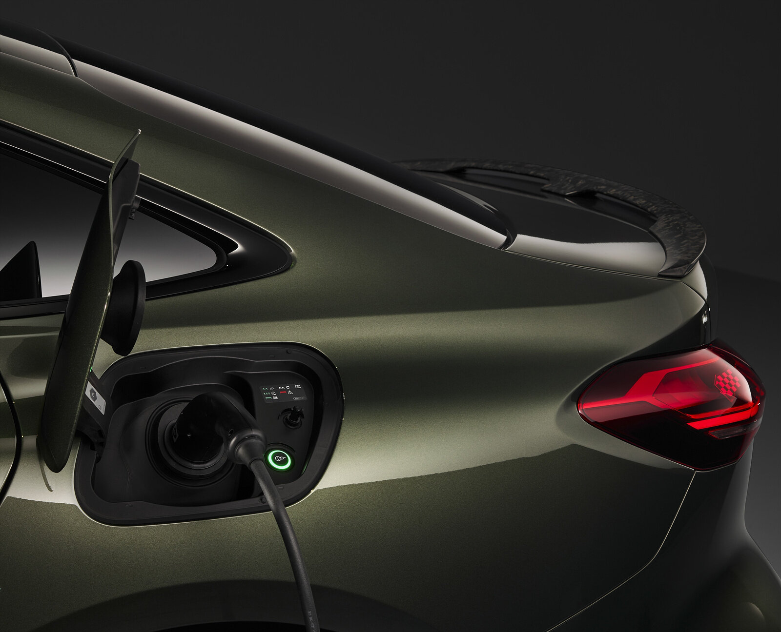

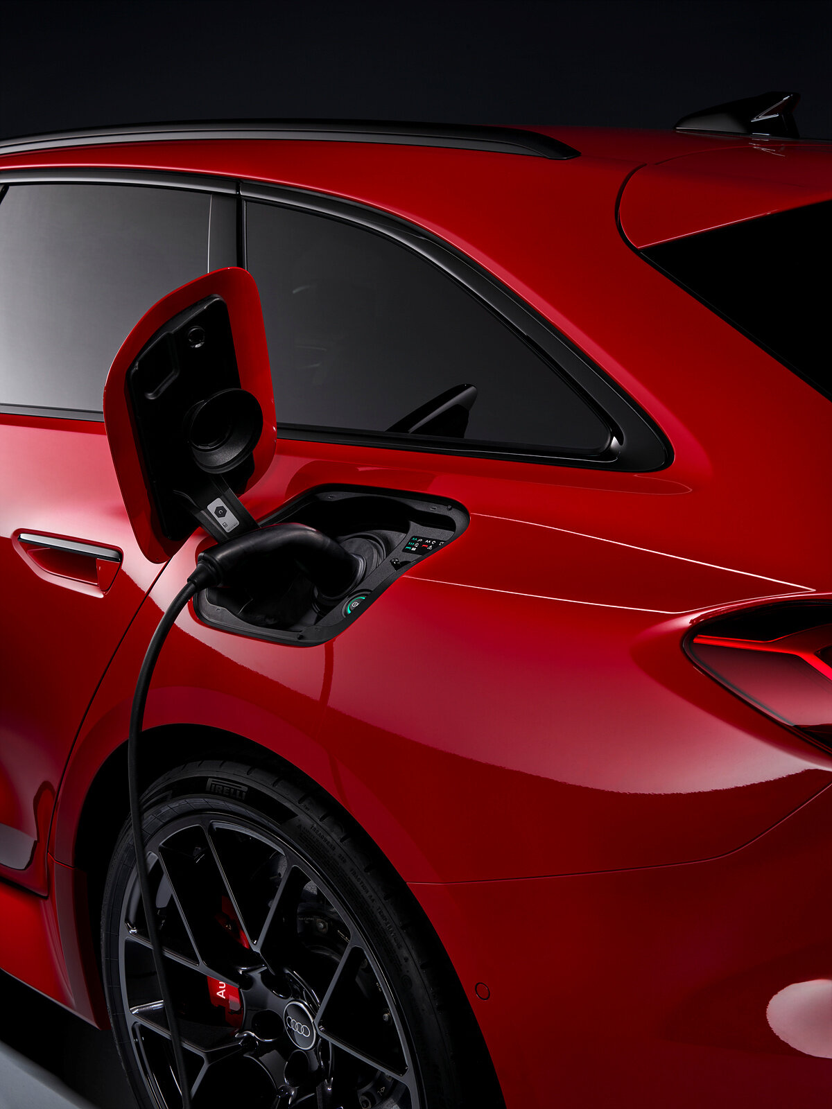

Battery and charging: improved cell chemistry puts more power on tap
The battery cells of the RS 5* are integrated beneath the trunk floor. Thanks to their improved chemistry, they output more power at low states of charge as well as in extreme temperatures than the previous generation. The battery not only powers the traction motor. It also sends up to 8 kW to the permanent-magnet synchronous motor in the torque vectoring unit.
Using three-phase alternating current (AC), the potent plug-in hybrid charges at up to 11 kW, meaning the high-voltage battery is charged to 100 percent in just 2.5 hours. A charging cable (mode 3, type 2 connector) is standard equipment. A high state of charge is essential to achieve the characteristics of RS-specific driving modes such as RS sport and RS torque rear.
When they are activated, performance comes first. To ensure full electric support is available – for example for torque vectoring – the vehicle holds the state of charge at a high 90 percent in the modes RS sport and RS torque rear. This means drivers always have access to maximum electric power for sporty maneuvers or dynamic acceleration.
The battery always reaches and maintains ideal temperature thanks to intelligent thermal management. Depending on the situation, it is cooled. The system dynamically reacts to the driving conditions and the power needed at any given time. When using RS sport or RS torque rear mode, the battery is actively cooled to an optimal 20 degrees Celsius. Pumps, fans, and heat exchangers work together to ensure full electric performance at any time. The result: constant power delivery and maximum spontaneity – even under repeated maximum load.

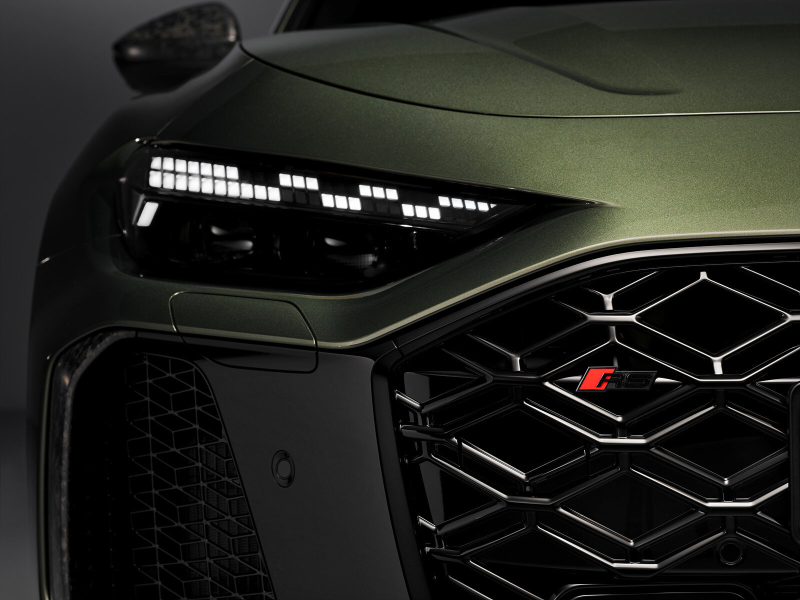

Its lighting technology reinforces the unmistakable character of the RS 5*. The second-generation digital OLED rear lights make a convincing statement for design and functionality. The exclusive light signature is designed to look like a checkered flag.
Like its sister models from the A5 model series, the high-performance hybrid’s digital OLED rear light 2.0 comes with communication light that can improve help improve safety on the road. For example, it can warn other drivers ahead of accident and breakdown sites. In addition, the communication light displays a specific additional graphic with warning symbols in critical driving or traffic situations.
