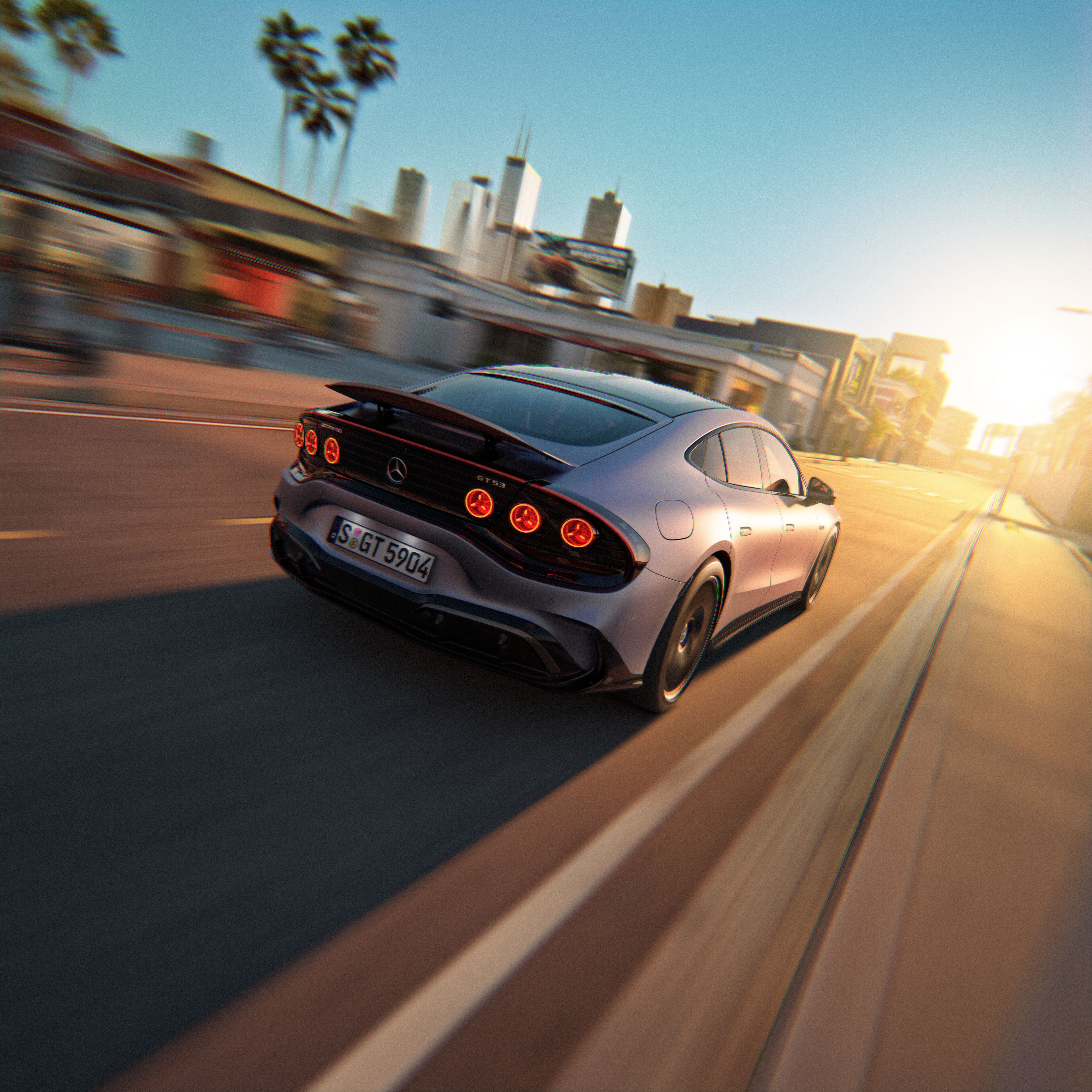

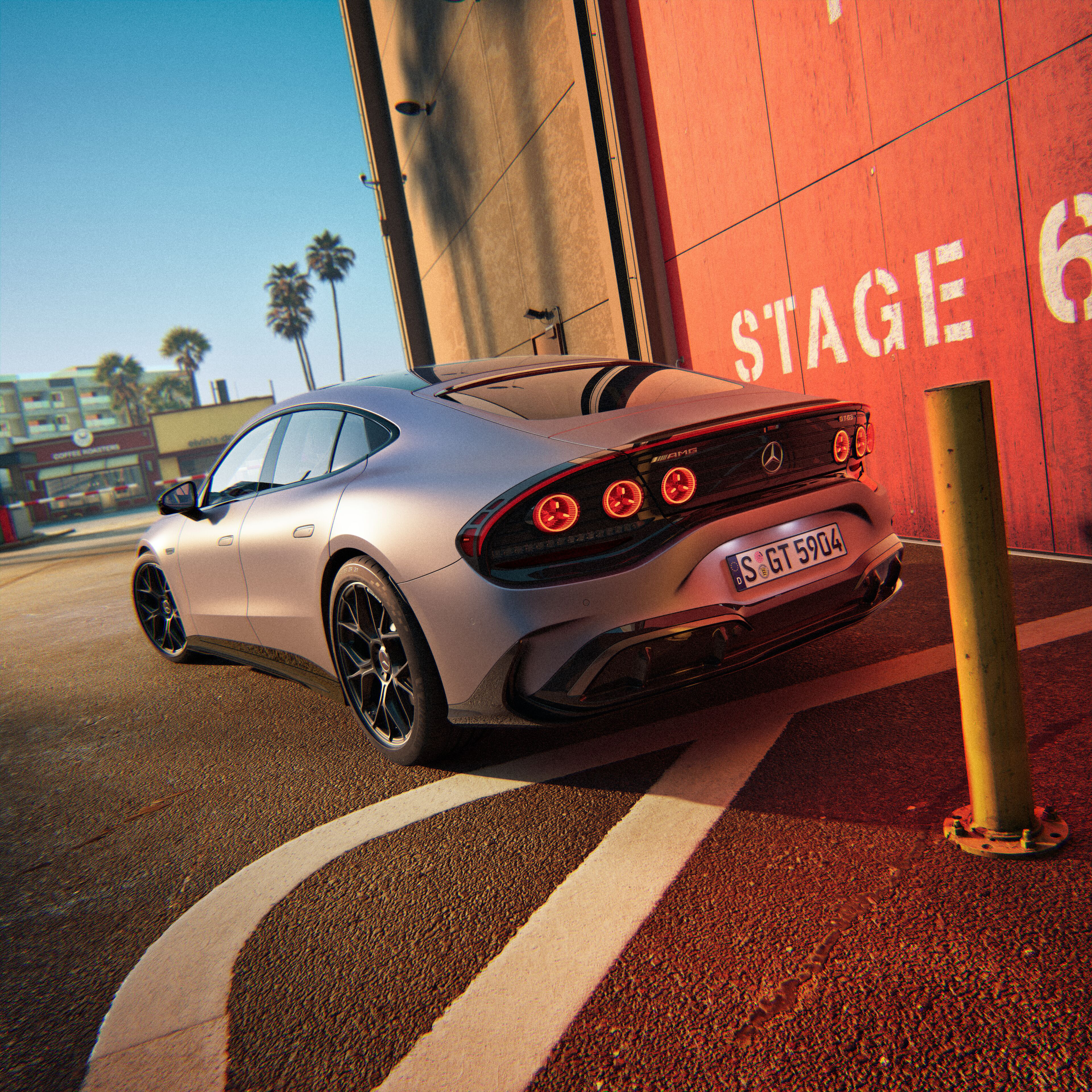

Active Aerodynamics at Both Ends
The GT 53 uses two active aerodynamic devices at the rear.
A standard retractable spoiler remains hidden at speeds below 93 mph to preserve the car’s clean fastback profile. At higher speeds, it moves through several positions according to vehicle speed, acceleration, driving style, and the position of the front Airpanel system.
The steepest spoiler angle is used when maximum stability and downforce are required. The driver can also deploy it manually.
An optional active rear diffuser extends the effective vehicle contour and manages airflow leaving the underside of the car. Unlike the spoiler, its primary purpose is to reduce aerodynamic drag during sustained high-speed driving.
The driver can manually extend both systems at low speeds through the car’s Aero Set-up menu—mostly for appearance rather than any meaningful aerodynamic benefit.

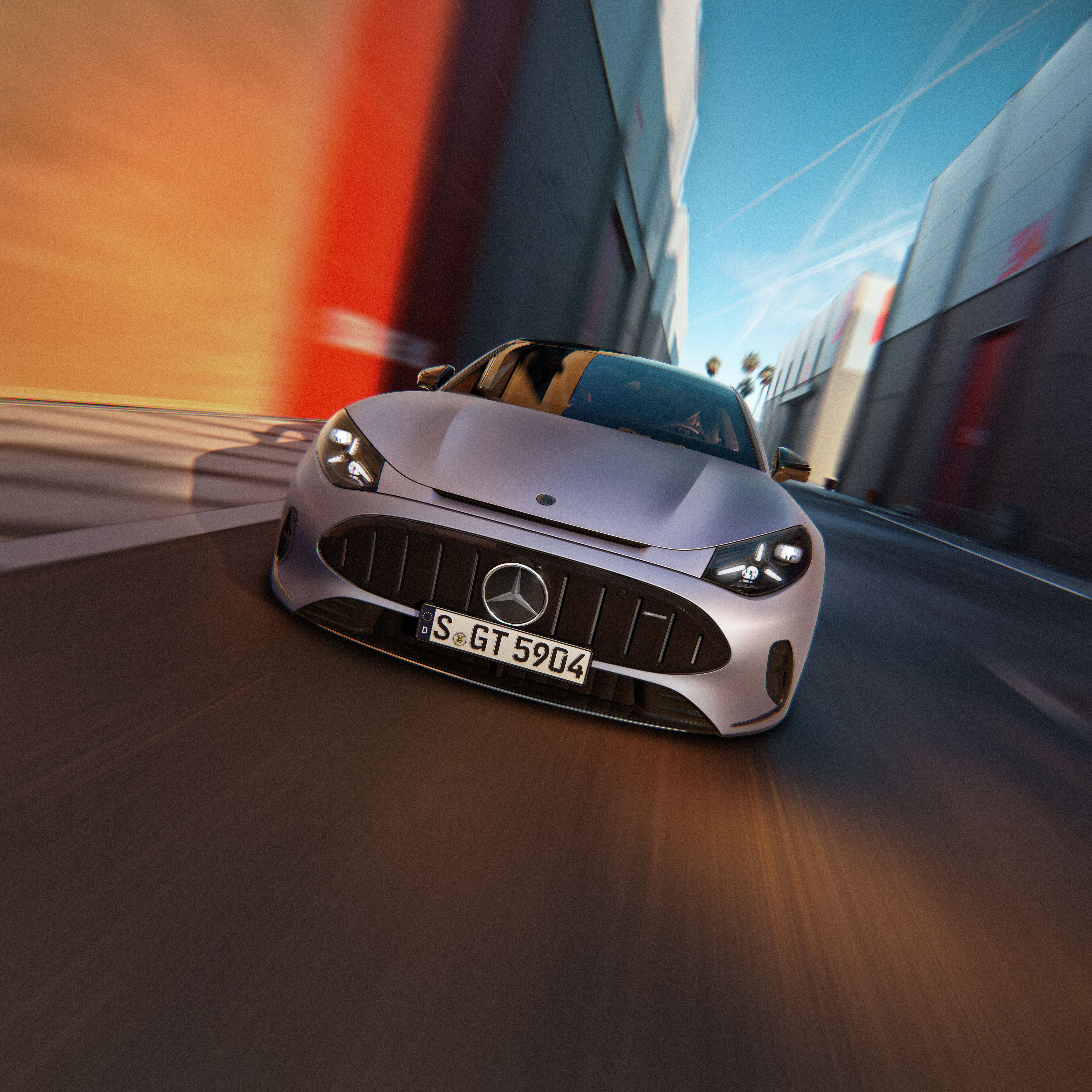

Mercedes-AMG quotes a drag coefficient of 0.21, a notable figure for a four-door performance car measuring more than 16 feet long and nearly 6.5 feet wide.
The new model is also approximately 1.6 inches lower than its predecessor despite carrying its battery beneath the passenger compartment.

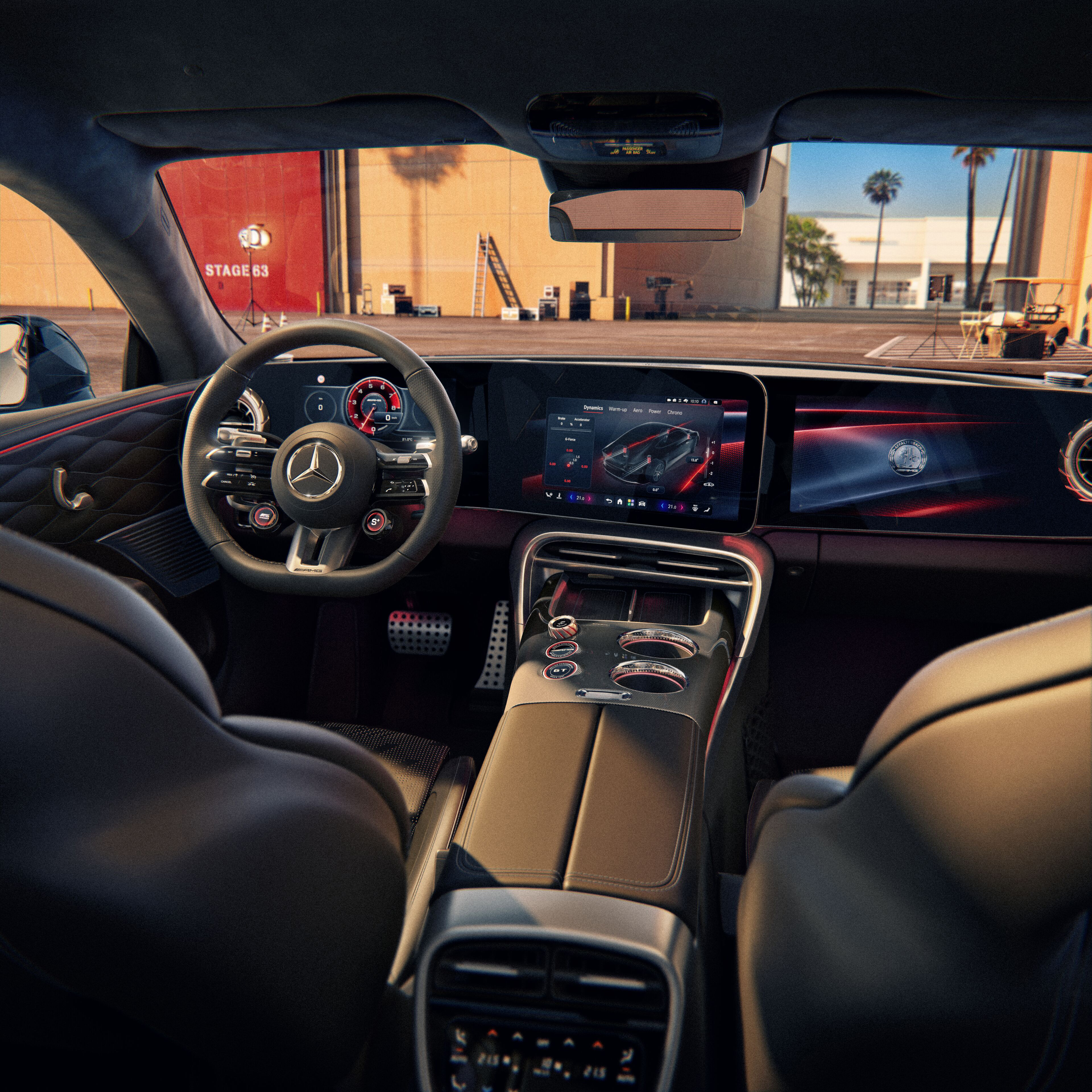

The GT 53’s interior follows the same basic layout as the more powerful versions.
The instrument panel and infotainment screen sit beneath a continuous glass surface, while a 14-inch central display is angled toward the driver. An additional passenger display will be available as an option.
The center console contains AMG’s Response Control dial, two wireless smartphone charging trays, illuminated cupholders, and a covered storage compartment.
Individual rear seats and specially shaped footwells emphasize the car’s long-distance role. A segmented electrochromic panoramic glass roof can switch between transparent and opaque settings.

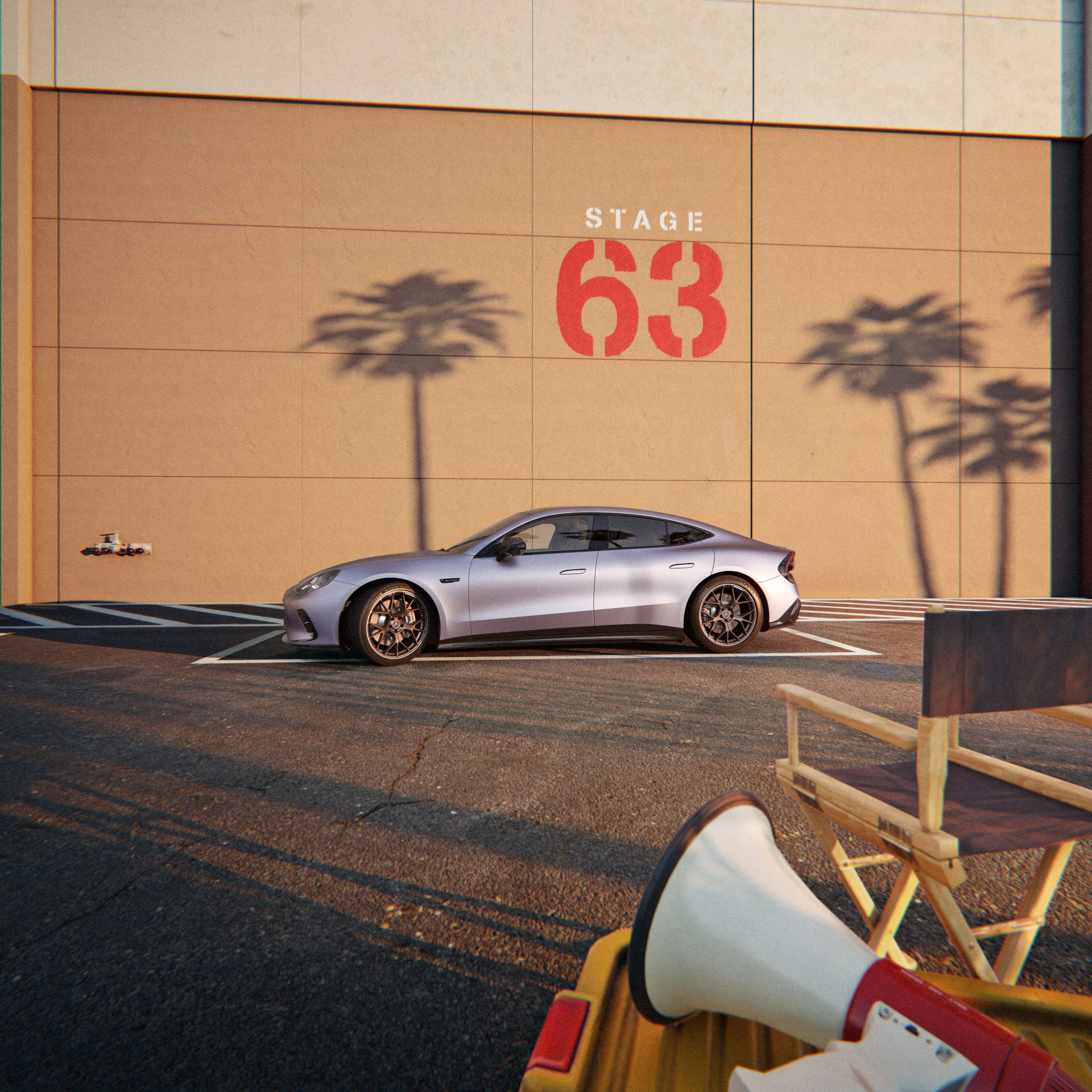

Length: 200.6 inches
Width: 77.1 inches
Height: 55.6 inches
Wheelbase: 119.7 inches
Curb weight: 5,236 pounds
Drag coefficient: 0.21
