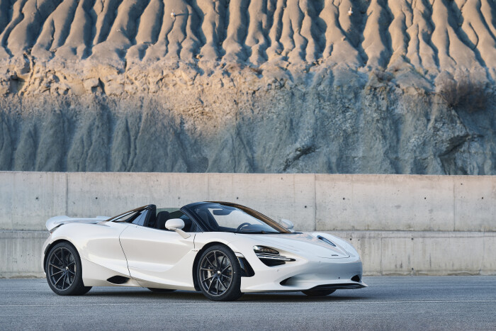

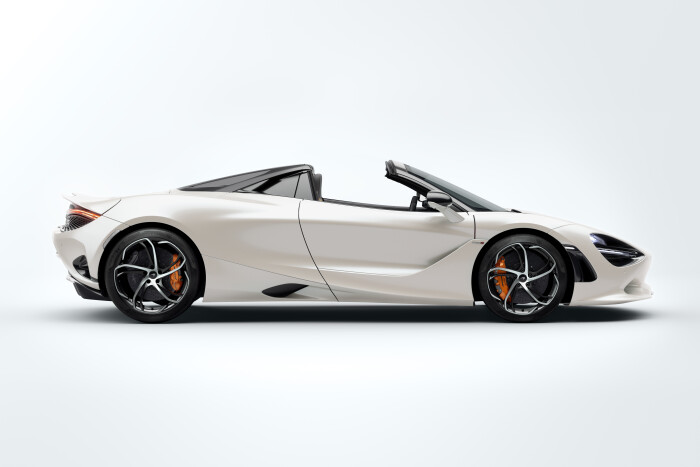

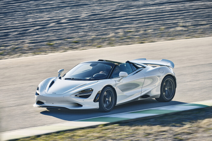

The 750S Spider is designed with the same focus on minimising weight. It features a Retractable Hard Top (RHT), rollover protection system and a bespoke rear upper structure to the monocoque constructed from carbon fibre, but such is the strength of the carbon fibre monocoque that no additional reinforcement is needed. This ensures the Spider is equally impressive in power-to-weight terms and segment-leading at 566PS-per-tonne, at its lightest dry weight of 1,326kg.

The McLaren 750S Spider has an inherent advantage over rival open-top supercars built with aluminium and steel because of the inherent stiffness and rigidity advantages of carbon fibre. The Spider needs no additional strengthening, and the changes from the coupe – the Retractable Hard Top (RHT), integrated rollover protection system and bespoke rear upper structure – are all constructed from carbon fibre. The new convertible supercar weighs just 1,438kg (DIN) – again, 30kg less than the 720S Spider. Its weight in dry lightest guise is 1,326kg.

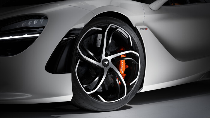

Formidable braking performance is enhanced by the larger surface area of the active rear wing, which fully deploys in less than half-a-second, increasing rear downforce to improve high-speed stability under braking and reduce braking distances. The carbon ceramic discs are paired with a new brake booster that improves pedal feel and modulation.
For 750S customers intending to use their vehicles extensively on race circuits, a new track brake upgrade comprising 390mm carbon ceramic discs and monobloc calipers. The discs take seven months to create – seven times longer than a conventional carbon ceramic component – but are 60% stronger and have four times the thermal conductivity. These virtues increase braking performance without a corresponding increase in the size or weight of the disc, yet also reduce brake fade and wear rates.
The combination of discs and monobloc front calipers derived from the McLaren Senna with a new brake booster and vacuum pump and Formula 1-inspired integrated caliper cooling ensures the track brake upgrade delivers precise pedal feel and consistency and incredible stopping performance under even the most arduous circuit conditions.

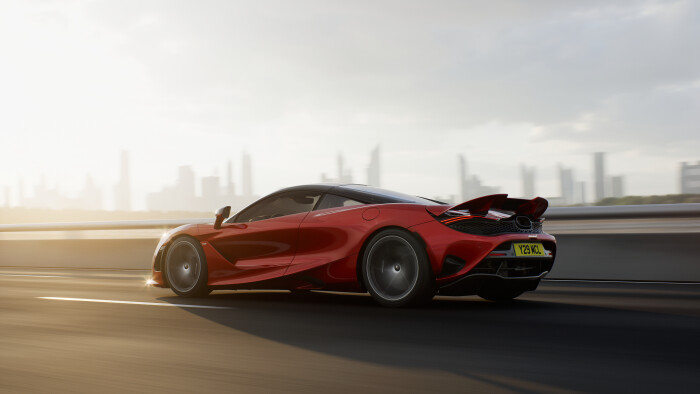

The surface area of the lengthened active rear wing is 20% greater than the wing of the 720S – further optimising aerodynamic efficiency – yet the component is lighter by 1.6kg due to its carbon fibre construction. A cut-out in the centre section maintains rear visibility and also ensures that high temperatures from the exhaust do not impact the wing when the vehicle is stationary after extended circuit running.
The hydraulically actuated wing is built at the state-of-the-art McLaren Composites Technology Centre (MCTC) in Yorkshire, UK, using new production methodologies unique to the 750S. Deployed at angle configurations and vehicle speeds that are individual to the coupe and the Spider, there are three main operational positions:
- Driver Downforce (active wing partially deployed, dependent on speed) is engaged when the Aero button is pushed in the cabin, increasing downforce levels during high-speed cornering
- DRS automatically delivers drag reduction functionality when accelerating in a straight line, up to the maximum vehicle speed
- High Speed Braking fully deploys the active wing in less than half-a-second, delivering significantly increased rear downforce that improves high-speed braking stability and reduces braking distances
The 750S is fitted as standard with Pirelli P ZERO™ tyres, with even higher-performance Pirelli P ZERO™ Corsa and racetrack-focused Pirelli P ZERO™ Trofeo R tyres as options. All three tyres are engineered specifically for the 750S by McLaren and its tyre technical partner Pirelli, as are the Pirelli P ZERO™ Winter tyres available from McLaren retailers.
10-spoke Ultra-Lightweight ‘Turbine’ wheels, 10-Spoke Super-Lightweight Forged Alloy ‘Strike’ wheels and 5-Twin Spoke Ultra-Lightweight Forged Alloy ‘Vortex’ wheels are offered, in a variety of finishes depending on wheel design: Silver, Dark Stealth, Gloss Black Diamond Cut, Gloss Black and new gold Orum. Buyers can also specify the ‘Strike’ wheel in a Dark Stealth finish with a McLaren Orange rim.

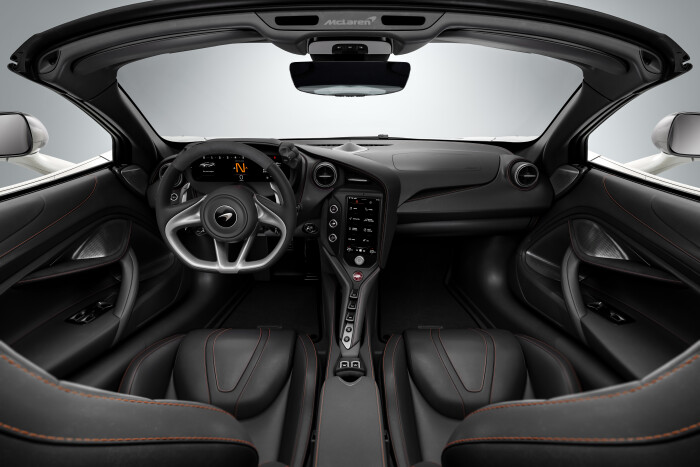

The cabin of the McLaren 750S is unashamedly driver-focused. Advanced technologies are fused with exquisite materials, but one of the most innovative elements is largely hidden from sight: beneath the soft leather and finely textured Alcantara surfaces is a strong and stiff carbon fibre monocoque that is inextricably linked to Formula 1.
When McLaren introduced the ground-breaking MP4/1 race car in 1981, its carbon composite monocoque was clearly superior to steel and aluminium alternatives. Immense structural rigidity created an incredibly stable platform that enhanced dynamic performance, and the light weight – only possible with carbon fibre construction – brought immediate benefits to acceleration, braking and dynamic performance.
More than four decades on, the monocoque at the heart of the 750S – while a high-tech world away from the MP4/1 – retains all of the benefits that advanced carbon fibre construction brings. The dihedral doors of the 750S coupe hinge dramatically upwards as they open, taking with them a section of roof, because the upper section of the monocoque can effortlessly support such a wide opening in its structure. This inherent strength is the same reason that the 750S Spider – which features its own bespoke doors – needs no additional structure reinforcement to incorporate a convertible roof.
The advantages of carbon fibre enable design of the ultra-slim A-pillars that aid forward visibility and the glazed C-pillars of the coupe and the compact tonneau buttresses of the Spider that improve over-the-shoulder visibility. Should a customer desire, elements of the carbon fibre structure within the cabin can be showcased in visible carbon fibre to underline the authenticity of the construction.
With the V8 engine so integral to the appeal of the 750S, McLaren’s personalisation programme gives coupe customers the option to specify a double-glazed panel with branded carbon fibre frame within the rear luggage shelf to expose the top of the powertrain. This is visible over the driver’s shoulder and visually brings the engine into the interior. It can also be seen from outside the vehicle, through the rear screen.
Carbon fibre is also used for the integrated frame and panel of the Spider’s one-piece Retractable Hard Top (RHT). Driven by eight electric motors, the operating mechanisms are near silent, and the strength and lightness of the RHT enables the roof to open or close in 11 seconds at vehicle speeds up to 50km/h (31mph).
The new suite of driver controls introduced on the 750S is no less technically advanced and brings significant benefits. The new driver-centric instrument display is in a binnacle that is mounted on – and moves with – the steering column. The binnacle also features the controls for the Active Dynamics functions on either side, meaning a driver doesn’t have to take their hands off the wheel to select Powertrain and Handling modes.
The steering column – now electrically powered as standard – and the beam structure on which the driver display is mounted are both new and stiffer, contributing to an improvement in NVH (Noise, Vibration, Harshness) properties.
The area adjacent to the central touchscreen, where the Active Dynamics switches were located on the 720S, now houses the buttons that control Launch and Aero settings, in an easier-to-use location. This is also where the control for an exclusive new driver technology feature that debuts on the 750S – the McLaren Control Launcher (MCL) – is sited. The MCL allows a driver to save their favourite configuration of aero, handling, powertrain and transmission settings using a button that features the famous McLaren Speedmark logo. This bespoke dynamic setting can be recalled with a single press of the same button to immediately return to their personalised McLaren driving experience.
As with all McLaren vehicles, the steering wheel of the 750S is deliberately free from any buttons or switches, allowing the driver to focus upon the feel and feedback from the chassis and road. Information and infotainment detail is accessed through the new driver display and the optically bonded, touch-sensitive Central Infotainment Screen (CIS), the latter enhanced by richer graphics and increased touch sensitivity. The Rear-View camera and Surround View system have both been upgraded for higher definition and clarity and the quality of the in-car microphone has also been improved for greater voice command accuracy and clearer hands-free calling.
Driver convenience features include Apple CarPlay®, allowing smartphone mirroring and the use of defined apps from the Central Infotainment Screen. An upgraded in-car audio system developed in conjunction with McLaren’s audio partner, Bowers & Wilkins, can also be specified as an option. Since 2015, Bowers & Wilkins high-performance audio systems have been available in every McLaren, the acoustic technologies maximising audio performance and pushing the boundaries of loudspeaker capability. To achieve the goal of revealing as much of the original recording as possible, new audio system elements in the 750S include a more powerful amplifier and the company’s proprietary Continuum® cone speakers. Radio reception is improved by a new antenna.

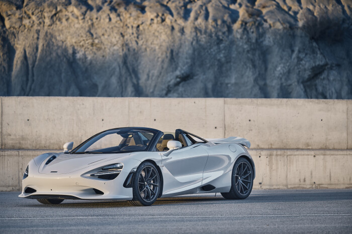

The 750S Spider features the same narrow A-pillars, and the carbon fibre lower structure is also identical to the coupe. However, the 750S Spider’s Monocage II-S architecture has a bespoke carbon fibre structure above the engine bay to accommodate the carbon fibre rollover protection system (ROPS) and Retractable Hard Top (RHT). The tonneau buttresses that shroud the compact ROPS, together with glazed flying buttresses that create a high-pressure zone over the rear tonneau cover to reduce rear axle lift, aid the visibility that is so important to McLaren drivers on road and track.

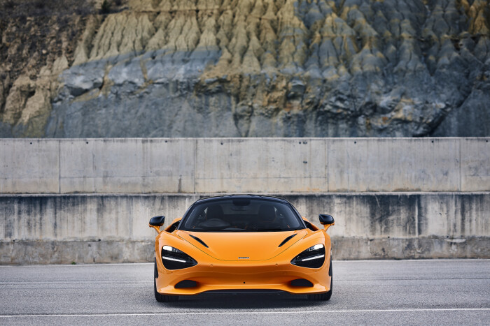

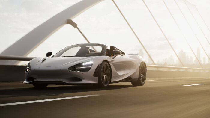

In the nose of the car, ‘eye sockets’ perform a double function, integrating digital LED lighting with a unique intake path for the low-temperature radiators, all while minimising drag. Just as intakes cut down deep inside the doors of the 750S, so too do these aero ducts slice into the bodywork of the vehicle, functionally highlighting how cooling airflow is driven into key areas.
The eye sockets are dissected by sequential indicators that sweep through thin LED light strips. Below them are the aero ducts that feed a low-temperature radiator (LTR) on each side of the car, cooling the seven-speed transmission and charge air coolers. Above them are particularly slim LED headlights, which are now deeply hooded followings revisions to the surrounding bodywork. The reprofiling does not impact the airflow into the LTRs, but instead narrows the gap between headlight and bodywork.
A new extended front splitter – providing aerodynamic balance in combination with the enlarged active rear wing – and new front bumper with sharper form language, dissect airflow at the leading edge of the 750S. The air is driven into the eye-socket intakes, channelled over and around the contoured nose of the 750S, or directed down to the flat underfloor.

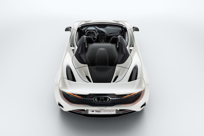

The removal of the fixed roof for the 750S Spider necessitates a revised gas strut position and door hinge system, but in this area, the only visible exterior differences to the 750S coupe are a longer front wing, shorter door and frameless window surround.
The design and positioning of the single, central exhaust pipe meant that the new active rear wing is positioned 60mm higher, its revised static position bringing additional powertrain cooling by drawing hot air out of the engine bay.
An additional enhancement to the 750S is the venting from the rear wheelarches; by pushing the bumper closer to the engineering hard points the rear tyres have been exposed, which reduces air pressure within the wheelarches. The resulting shape of the rear bumper has less physical volume and serves to guide the expelled air upwards.

| Brakes | Carbon Ceramic Discs (390mm front; 380mm rear) with aluminium brake calipers (6-piston front; 4-piston rear) |
| Wheels (inches) | Front: 19 x 9J; Rear: 20 x 11J |
| Tyres | Pirelli P-ZERO™ standard. Front: 245/35/R19 93Y (XL); Rear: 305/30/R20 103Y (XL) Pirelli P-ZERO™ Corsa and P-ZERO™ Trofeo R available as options. |
